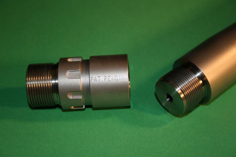

Has anyone seen this new patented barrel system by Wolf Precision. Supposed to be by BAT and when need new barrel, just thread on new barrel to the separate chamber mounted on BAT receivers. Wolf says that they are only ones doing this.

I would be conscerned with gas cutting/leakage at the joint. The Fit/Finish would need to be flawless. Novel idea though.
I experimented with the same set up over 20 yrs ago . The gap between barrel and chamber carbon fouls and erodes quickly . It's not feasible , if it was the military would have been doing it 50 yrs ago .
A system that worked better , at least for me , was to have the chamber neck in the barrel . There by eliminating flame cutting and deposits .
It's definately not new as my experiments 20 + yrs ago were based off WW1 machine gun barrel testing that I read about.
Since you still have to dial the barrel in, thread it and put in some sort of a throat all it saves you is chambering and breaching for the type of action. Depending on the chamber size 20-40 minutes. I just really don't see the point of it. It's just something else to sell.

I guess if you had more than one chamber, you could shoot different cases through the same barrel, say .260 and 6.5 x 47L. I can't imagine why I would want to, but someone might. Seems like a solution in search of a problem.

I can see some uses. Let's say you load up some 185 gr bullets and some 215 gr bullets for a match, planning to shoot whichever one the conditions favor. You could screw off the 215 chamber and install the 185 chamber.
Of course you could do the same thing with two chambered barrels. I'm betting the chambers are more expensive than a complete chambered barrel, but you only buy them once, I guess. You still have to have the barrel threaded though. What are we saving?

The throat is in the barrel and not in the chamber so you'd be changing out the barrel for different a throat length. Barrels at one time were listed at $550 (threaded at muzzle too) and chambers $485. So once you've purchased a chamber a fresh barrel ready to screw on is $550 with no fitting, order it and have it screwed on. Fits Bat Tactical Action and newer Bat HR and Bat VR's.
Interesting. So I guess what you gain is the ability to get a barrel quickly as opposed to having to buy a barrel and then having it chambered. Not a real advantage to me, but I can see how it would be for some.
Or for $550 you can call your gunsmith and have a whole new chambered barrel sent to you ready to screw on. I guess I still don't see the point?

I'd like to see a replaceable throat insert incorporated into the barrel itself, as well. Is it absolutely necessary that there be rifling in the throat itself?

I think if you were a short range benchrest guy you could have a bunch of barrels threaded and try to find the best 3 or 4 for next season and do it all in one day at the range.
Or for the same price you could have 3 or 4 complete barrels and try them all out in one day. Barrel swaps are easy.
