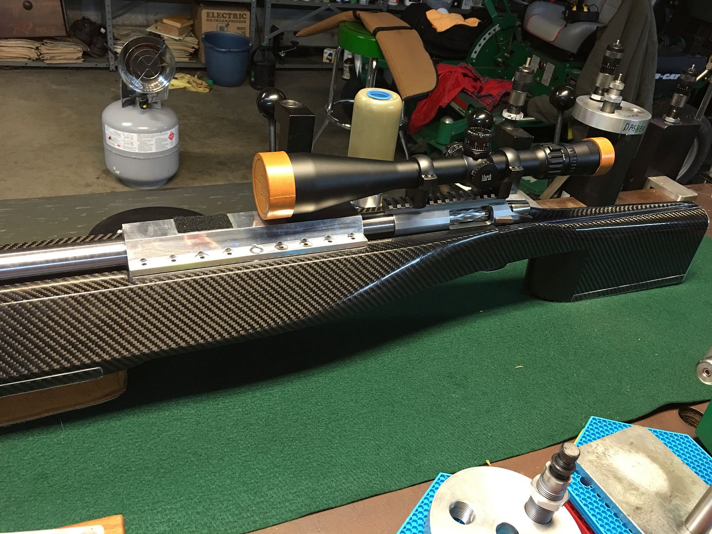

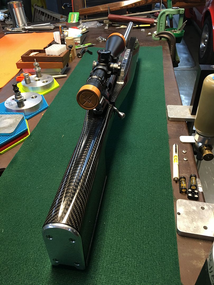

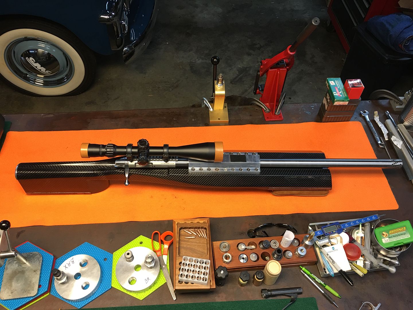

Time to bring this oldie back to the front. This was my last XC I was building about this time last year. It took either 1st-3rd place in every match last season by either my son or myself in the class we shoot at 1000.
Kinda a fun build to make a 12# gun.
Started off by tearing down a BAT B RBLPRE short range PPC/30BR gun, adding direct mount 20 MOA BAT rings, a 30” Standard Plama Krieger 8 twist and a Harrell’s tuner. Then I fitted it with a KSS Straightline Edge LV filled stock at 25oz, since those short range stocks don’t work very well in the 1000 yard game. Action and stock came in around 4#’s and I had 8#’s for rings, scope and barrel.
To perfectly balance it, I ended up using a 6x1/2” rod in the stock made of tungsten. Topped it off with an SIII 10x50x60. As you see it, comes in at 11.98 lbs.
Sure won us a lot of bling in 2018!
