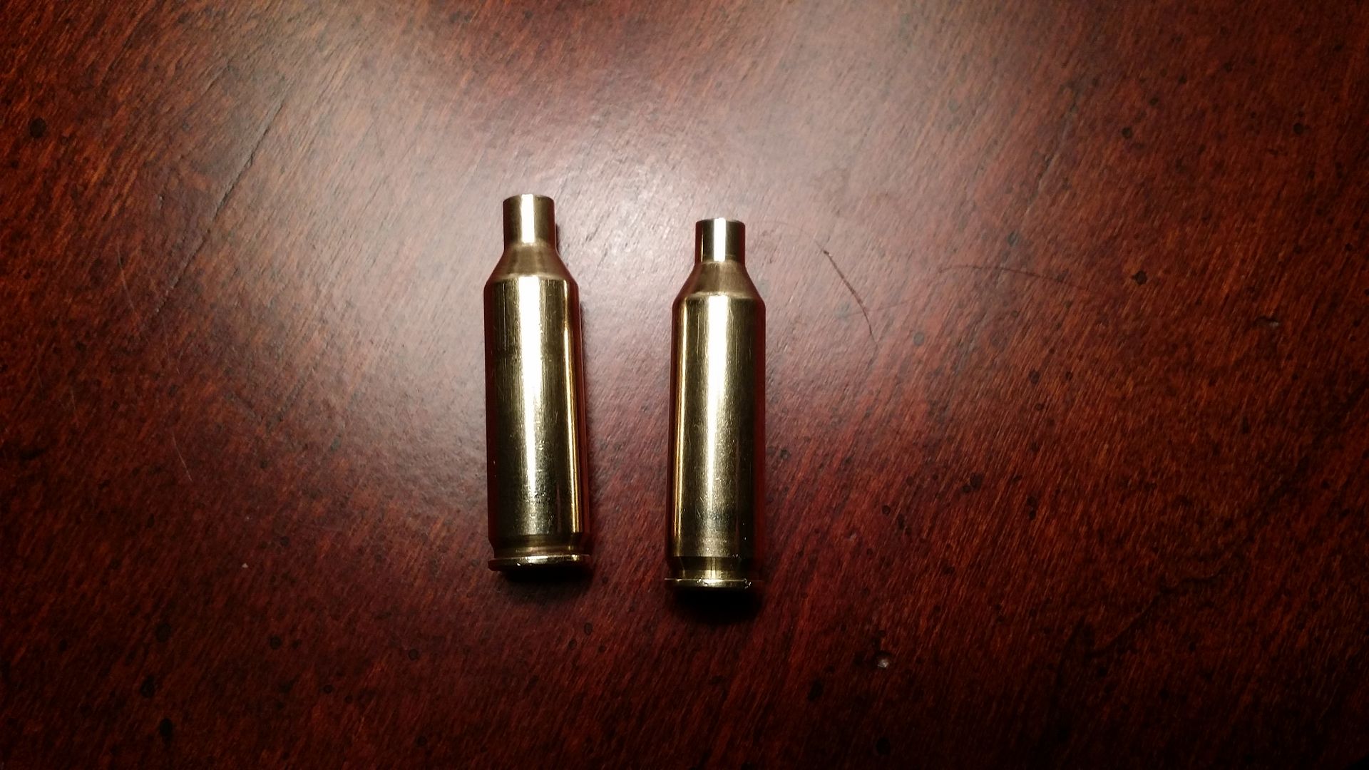

I love the .17 Fireball, but it can be very difficult to find brass when I need it. I knew it was possible to form .17 and .221 Fireball from standard .223 Rem brass and others have done it, so I figured I'd give it a try. I started with once fired RP .223 Rem brass that I ran through the annealer first to help make the forming go easier. The brass was run through a series of 4 different dies, rough cut to approximate length, trimmed to length, chamfered, deburred, run through a .17 FB full length sizer die, necks turned and reamed, primer pockets deburred and uniformed. Brass will be run in SS pins to remove the case lube and annealed one more time.
It took a little while to get everything dialed in and it isn't a quick process, but I'm very pleased with the outcome. The case on the left is a resized case from once fired RP .17 factory ammo and the case to the right is the case I just formed.

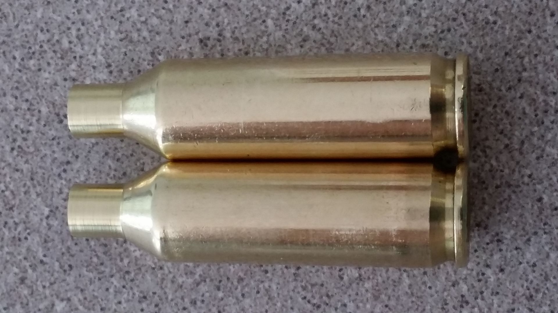

I should be cleaning up my mess in the basement, but I couldn't help fine tuning a little further. I was conservative when turning the neck. I could and probably will turn down a little further, but I wanted to be very careful not to cut into the shoulder. I promise cleaning the basement is next on my the list.
I did throw the factory brass on the neck turner just to clean it up for a better comparison. At this point, I'm guessing after one firing even I'll have to look at the headstamp to be able tell the difference.

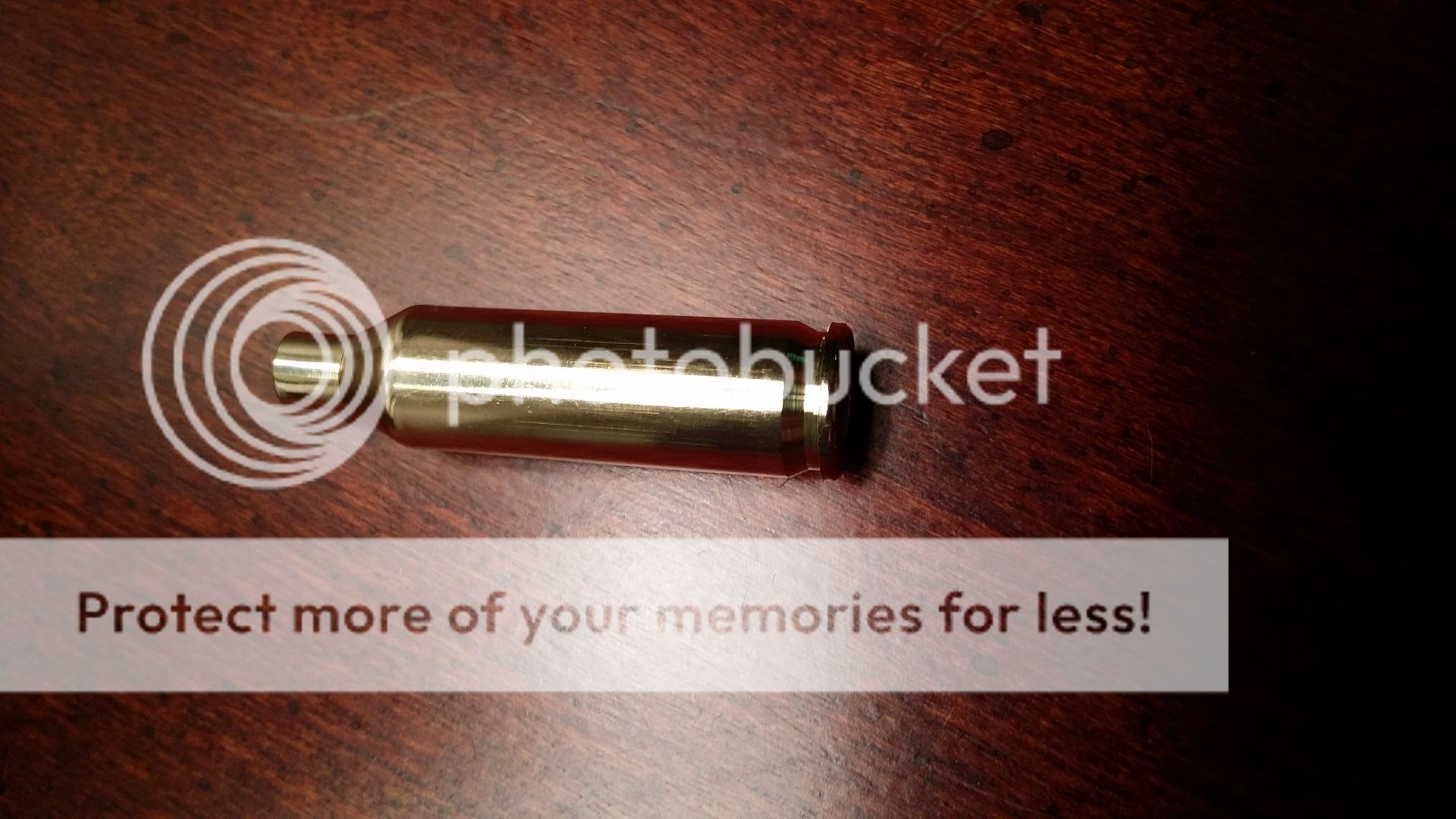

I was just about ready to head up to bed, but you guys had to tempt me. Yes, that's right Lapua .17 Fireball from .223 brass. Formed up easier than the RP actually.
