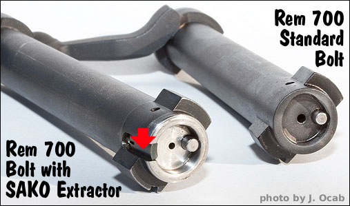

The ejector is pushing the case forward
Is this still the case with a Sako style extractor? I was under the impression that extractor claw passed over the rim of case at loading (and prior to firing). It takes very little pressure for the Blaser extractor claw to pass over the case rim. If anything, it would appear to pull the case backwards (and torque it sideways) rather than push it forwards
Ugh I think I’m getting confused between extractor and ejector... but I still feel like the while the ejector is pushing forward the extractor is holding the case back. The net effect being it is being skewed in the chamber given we have slop in CBTS (headspace), neck and jump.
Stick a case on the boltface and see how far forward the case can go before the extractor stops it. Its very loose. Extractor doesnt pull it to the face at all
If you look at the center case below, the amount the primer is protruding is how far the extractor let the cartridge move forward. Meaning even at "headspace maximus" the extractor held the case close enough for the firing pin to set off the cartridge.
