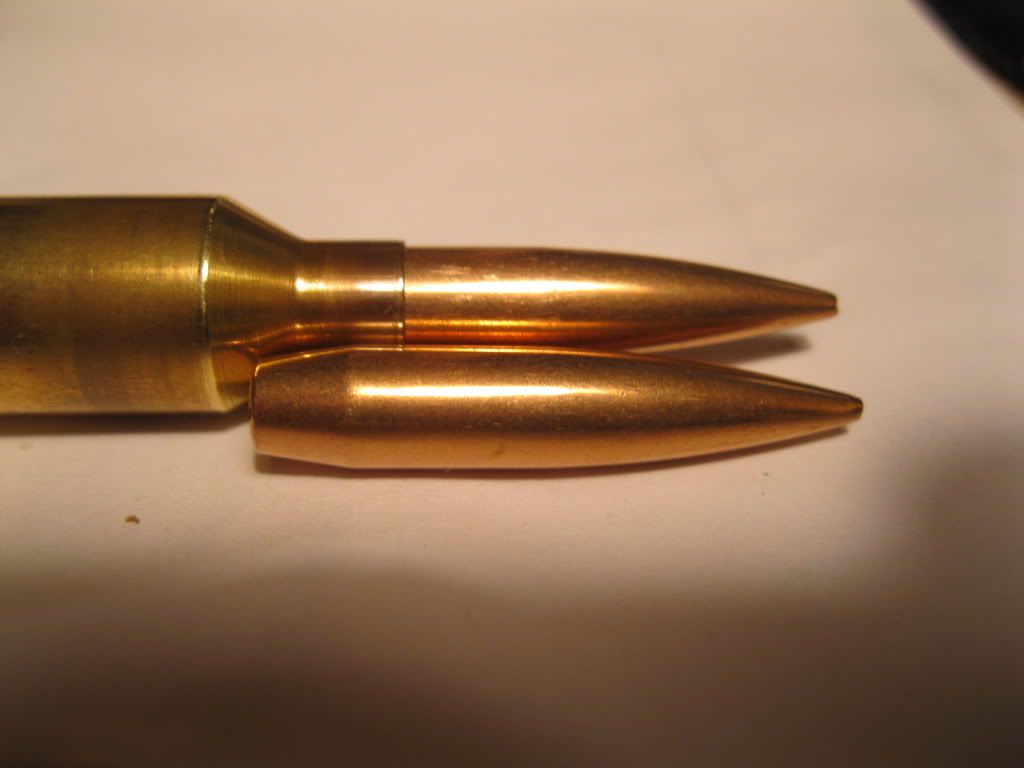

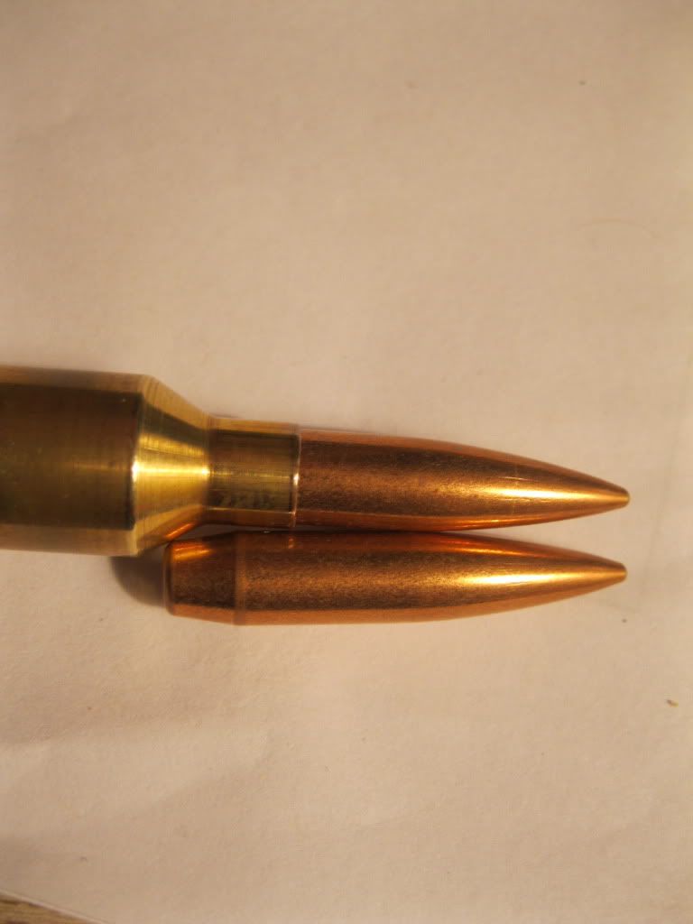

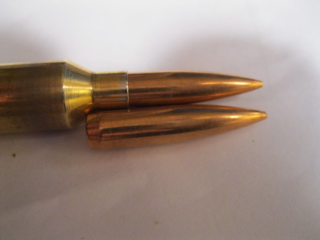

With all the talk here asking about freebore I thought I`d post a few pictures of America`s most wanted..... 8)
105 Berger VLD set to max jam.
Here is a Berger 108, same chamber set to max jam.
Again the popular 108 Bib BT same chamber max jam

That's good, but you forgot to specify your freebore!
I'll wait to see the print, but some new guys may not know what they are looking at so might be better to edit OP with freebore information. Just my $0.02
Re: Freebore Mug Shots 6BRX
My intension was to leave out the freebore. Let what you see dictate if this is a good one or not. Much whirling around about freebore. The answer will come forth, just having fun. I have 18 to 20 reamers by Forgreens, Clymer, JGS, Henriksen, and PT&G. I know numbers are important.
I may set up more pictures with a different freebore for all to critique.
Fun ain`t it..... ;D

Are you saying you want us to try to guess what the free bore is on the reamer that would make those bullets sit where they are in the pictures you posted?
If so the please first tell me what's the "max case" length number on the reamer we are starting from and also what throat angle we are working with (otherwise you are cheating by not giving us enough info to begin to make some intelligent guesses)?
Flat out, if the max case is 1.570" and the throat angle is one and a half degrees, the proposed free bore dimension of .120" is likely too short for those pictures.
