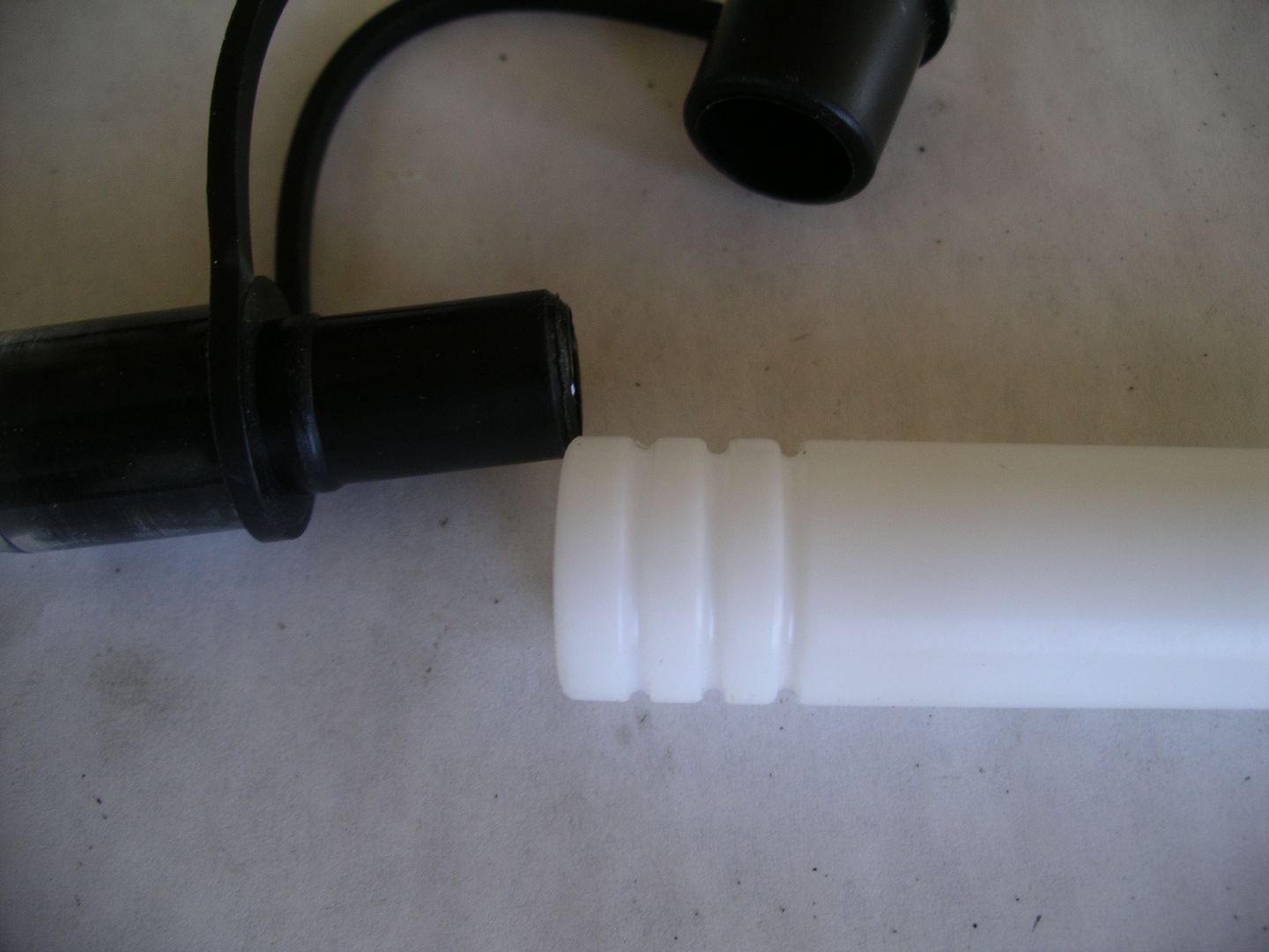

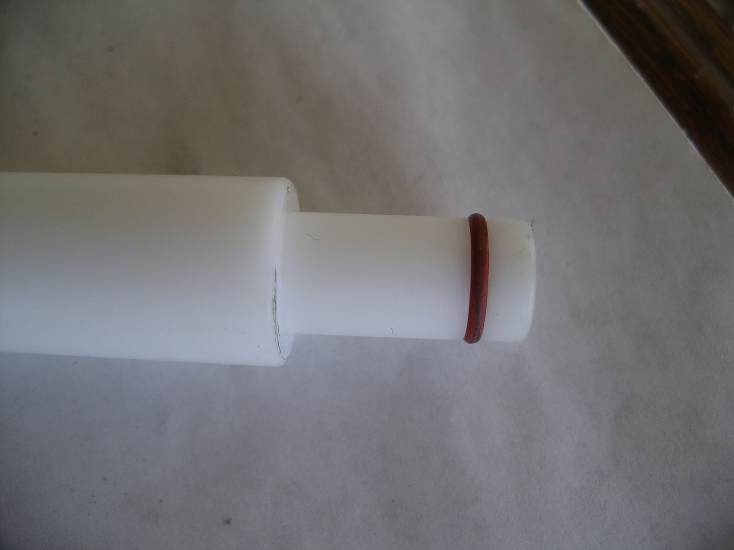

We hunted with a system like this for many, many years, finest barrels made. Letting barrels cool is foolish to think of when it is 90*, they never cool.
4 oz of water down the barrel, follow with 4 dry patches on on a tight punch type jag, dry chamber, back to shooting, all in 3 minutes once you get the system down pat. The adapter is available at Wall mart or parts store to put on an quart oil can, $3.

Water down the bore is an very good idea, we used it for many, many years, never an issue. Bill Davis recommended it to us.
As you use the tight patches to dry out the barrel, you remove a lot of carbon so your shooting strings are doubled at least.
That 3$ unit from the parts stores is magic for this application. We usually had cold water in the cooler, warm works well also, just not quite as fast.

Sounds like your water was hot that you cooled the barrel with. 2 Liter bottles work well(keep them in the cooler) and since you use 4-6 oz of water, you cool it many times. Remember, use a TIGHT punch type jag, 4 patches, dry the chamber. Those are bore guides from Sinclair.
