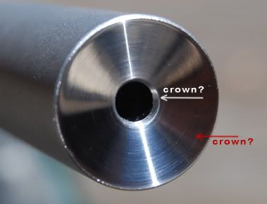

Barrel Crown...what is it exactly?
I've read and heard a lot about "make sure the barrel crown doesn't have any nicks or burrs in it" as this reduces accuracy.
I'm confused as to what exactly is the barrel crown. Is it the entire end of the muzzle? Or is it just the very small recessed area where the bullet exits? Here are some pictures to hopefully clear up my question.

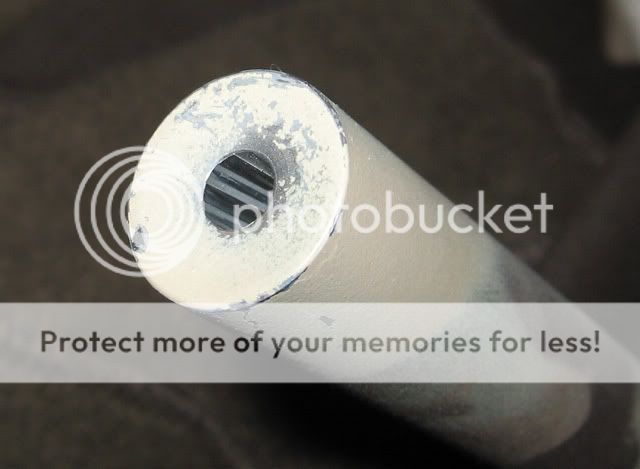

This is my rifle...does the paint on the muzzle have a negative effect on accuracy? Also mine does not have that recessed area like the picture above does, well it does it's just very small.
Hey Flinch,
Your crown on the lower picture could cause you problems. You should take all of the paint off of the end of the barrel it might not let the bullet exit correctly.
Your red arrow and white are both the crown. Some smiths will do a two step system like the one in the top picture. The purpose is for the bullet to clear the barrel on a sharp edge and get the same release every time.
The place that is referred to in the advice that you mentioned is the actual edge where the bore ends. It is also true that the entire end, out to the corner where it meets the side of the barrel is called the crown. Because of ease of production, and the sheltered life these rifles lead, many Benchrest crowns are at 90 degrees to the bore with no recess or chamfer. The chamfer or recess that are so common are designed to protect the edge of the bore.
I re-indicated the crown in your photos. The crown should be perfectly square with the bore and the edge should be sharp and clean. If you place a bullet in the bore, everything the bullet touches is the crown. Care should always be taken to keep the crown protected from damage.
Seems like som mis-definitions here. The "crown" refers to the entire end of your barrel,not just the intersection of where the crown meets the bore). For example an "11 degree crown" refers typically to the end of the barrrel machined at an 11 degree angle, this may be sharp at the bore or have a 45 degree chamfer, etc.
The top photo you have indicated looks like it is an 11 degree crown with a 45 degree chamfer at the edge where it meets the bore. That being said, it is really the edge of the crown,where the crown intersects with the bore) that is spoken of to have the most effect,good or bad) on accuracy.

Many manufacturers referred to the type of muzzle shown below as a "recessed crown" or "target crown". The recess, of course, refers to a zone extending beyond the edge of the bore.
Alan Warner, who is one hell of a gunsmith, also calls a muzzle-facing like the above a "recessed crown". However he distinguished this from the edge of the bore by calling that the "actual crown". See: http://www.warner-tool.com/Custom%20Rifle.htm
Confused yet??
So, in some applications, the word crown refers to the charactistics of the muzzle face. In other situations, as when someone says they have a "burr on the crown" they are probably referring to the actual front edge of the bore,the last metal the bullet contacts on exit).
I think we need to accept that "crown" is used multiple ways and that the terminology lacks precision. Perhaps in German there is a specific word,other than "crown") to describe the actual edge of the bore at the muzzle and ONLY the edge of the bore.

The reason the crown is so important is that it's the last place the bullet touches the bore. If it is damaged or irregular in any way it will impact the bullet's path. The recess, however you cut it, is to protect this area. It's probably more important on a field rifle than a BR gun. Your second picture with the paint would likely not effect accuracy as long as none of it touches any port of the bore.
