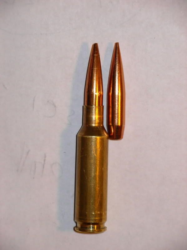

6.5x47 freebore for 140 Bergers
Chris Matthews, Longshotrifles http://www.longshotriflesllc.com/ used PTG reamer print # 11724. It has a .294 no-turn neck and .104 throat. My dead-on OAL for 140 Berger VLD hunting bullets is 2.738". As this is a hunting rifle, I set the bullet 10 thou off the lands.

Whitley says 0.160" is ideal. After a BUNCH of measurring, thinking, and calculating, I had my 6.5x47 throat deepened out to the equivalent of a 0.177" FB. I wanted to be able to shoot the big Berger 140 VLD as well as the Berger 130 VLD and the Scenar 123/139 bullets. This freebore will do it.
I'm measuring a COAL of 2.822" and a base-to-ogive of 2.158" for the dummy round used to set the throat. HTH.
