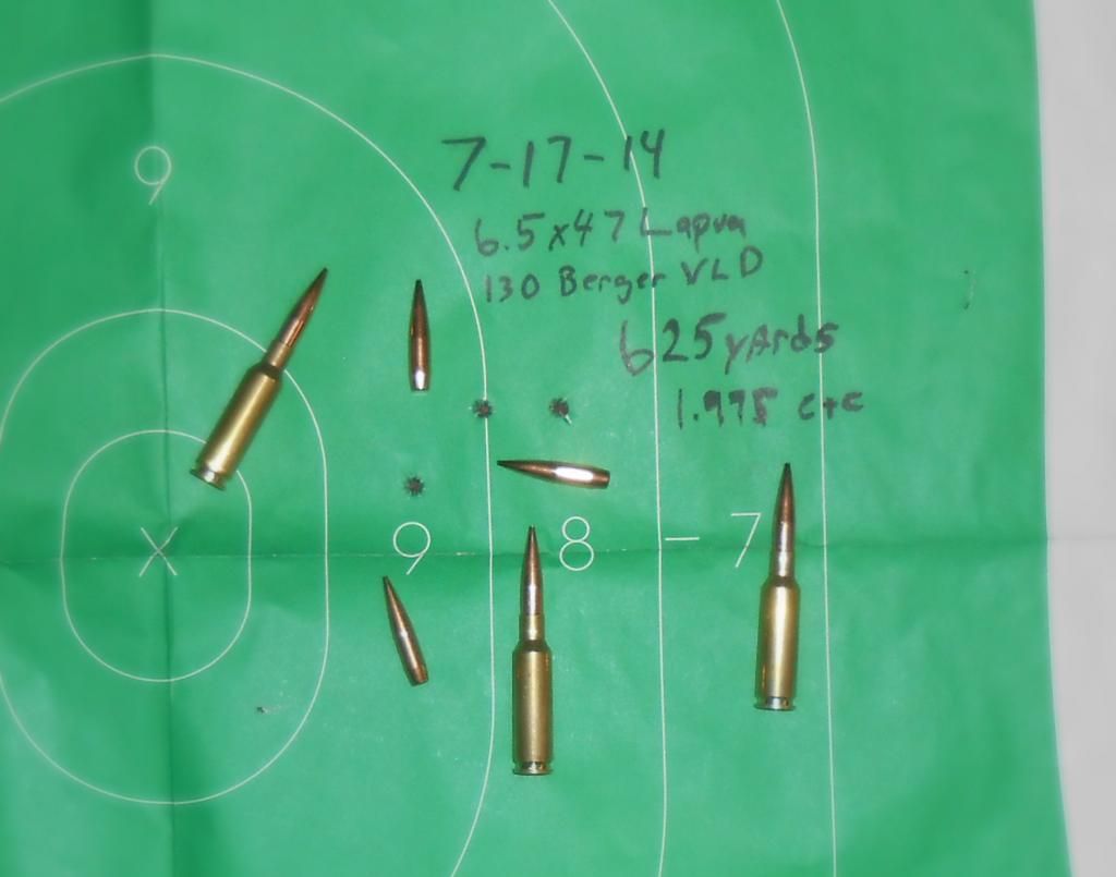

Never had great results with the 140s in the Lapua. Try Berger 130 hunting VLD with 43gr of H4350 compressed and BR4 primers. It yields a little over 3000fps with one little hole that you need a caliper to measure after 5 shots from my 700 action with a kreiger barrel . Seated around .005 off the lands this load will shoot equally well in my 27" barrel or my 20" Patrol rifle. I only lose 100 fps in the shorter barrel believe it or not!
