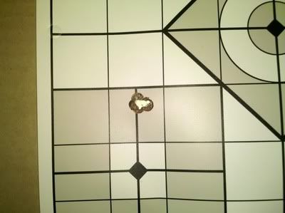

I have a 22-250AI 8 twist and a 12 twist try the 53gr Amax in your 12 twist Im still working up a load in the 12 twist but so far the 53gr Vmax is working pretty good this is the first group with the 53 Vmax

thats a good start there how much more do you need to improve that? what is the load

If he played with neck tension and or seating depth it probably would tighten right up.

The load is 35.5 grs Varget 3644 fps avrg I think I can get a little more velocity that load was almost the max for a standard 22-250 but not bad for a fire forming load
nice job there
now that you have your brass formed and that group from it what are you going to do with your powder load? i meen are you gonna do a ladder up to max or how do you do the load development from here?
I'm setting this up for a varmint gun which in my neck of the woods means groundhogs if I can get another 100-150fps and the groups stay this size I'll call it good enough.
I'll just work up in .2gr increments until I see some pressure signs
i was just wondering with the ai rounds i have been told to fire form with a max load for the parent case and then work up from there, but that the ai case can take much more powder. i am just wondering since i have no experience with the 22 250 ai.

This is not a bad group at all period, but if this was a fireforming group and if it is repeatable it is excellent so excellent in fact I wouldn't waste one shot fireforming at paper or for no reason, I would be killing GH's while fireforming, obviously a well put together rifle and you have done a good job tuning your fireform load, I hope your full house loads are as accurate, your rifle will be a blast while it lasts.
