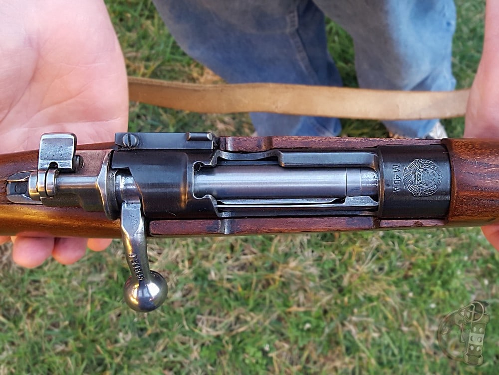

I ended up building the Yugo M48 in 6.5-284 Norma, sure turned out sweet. 27" barrel, Boyds Walnut stock. I worked the stock trigger to 2lbs breaks like a glass rod. Had to open the feed rails just a tiny little bit and it feeds like a charm.
This old Yugo had been opened to a Magnum bolt face many years ago, I had to rebuild it to a standard bolt face. Lots of work actually...

The Yugo M48 is not your typical military grade Mauser, they were built in the 1950s-1960s and were FORGED. Should be as strong as any commercial action of that era was. I read they have been tested out to 100,000PSI so I have no worries about the strength.
Also there was NO back tenon or anything else different about the barrel or bolt, the bolt has a standard 98 configuration as was the original take off barrel. Besides being a bit shorter than a standard 98 everything else is the same, on this one at least. I was able to use a 98 Mauser extractor, trigger, safety, cocking piece, and bolt shroud, without any modification (I had long ago lost most of the original parts). The firing pin is SHORTER but that's about it....
The big job on this one was rebuilding the bolt face from magnum back to a standard bolt face. I didn't want to "solder" a ring and machine it, I turned the bolt face flat in my lathe, welded on a new 01 tool steel piece of round and machined back to original Mauser specs for the standard bolt face. I never got the front lugs hot enough that I was not able to touch them, welded one spot at a time, let it cool, over and over until it was done. Everything works fine and the bolt is spec now.
