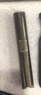

Can someone confirm if this is a Yoke End Play Adjustment Tool?
Never saw a tool like that. Trying to think what it would be for on a S&W. Easiest way to take up the play is with the Power Custom Cylinder Endshake Shims. One could also stretch the crane, using a tight fitting mandrel inside the crane, and using a Brownells tubing cutter like tool to roll stretch the crane, then trim to the correct length.
I thought he said "yoke end play", not "cylinder shake". Two different conditions......
Your right, my bad! My pea brain went immediately to talk mode, instead of think mode. I do that a lot lately! For yoke play, I used to just peen it a small bit, and used a fine file to adjust the slot. Seldom had that problem though, compared to cylinder end shake.
That tool perhaps may be a homemade gauge for checking the yoke slot? Never saw one like that before.
