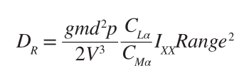

This is for a 168 grain Sierra fired at a Mach 2.4 (2700 fps) from a 1:10" barrel. The center of this shape is slightly offset to the right for right hand rifling and produces a tiny average force that pushes the bullet to the right. With a good bit of math we can estimate how much the spin drift is by the equation:
This is one of the only good reasons not to over-spin a bullet. If the bullet is stable at a 1:10 twist and you fire the same bullet out of a 1:8 twist, the increase spin (p in the equation) will increase the spin drift. For a well designed rifle and bullet combo, the spin drift will only be about half of the Coriolis drift and the Wind drift will dominate the cross range motion of the bullet.

Yep, bullet integrity is another reason. Also for fuse activated warheads the direction the nose is pointed really matters. Finally, for really high angle trajectories like artillery and anti-aircraft the bullets fired with too much spin they can actually flip at the top of the trajectory (apogee) and hit the ground ass first.
For y'all and accuracy, over spin mostly just increases spin drift.
