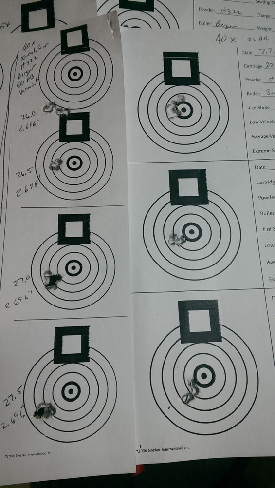

I've posted this in the last...I put together a vintage theme 40x this past year and went with a 12 twist 1.25" straight tube for a 22 BR. The barrel looks very good inside, machined very nice as well. I started off shooting lighter 52 SMK's and right off the bat I could not get anything working with 8208 and Varget. Had some H322 on had I had since 1995 ish and got some promising groups out of it. Switched to 60gr Berger Varmint bullets and it shoots them well. I had some nice groups at 300 and 500 yards with it. Overall, the barrel is decent...cleans up nice too.
Here is some of my early load testing targets...took me awhile to get something that consistently working...
