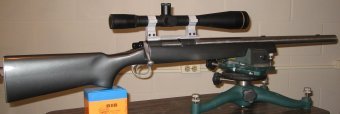

Trapper99 I did what you are talking about doing,but wish I had gone with a custom action now that it is all said and done. I had the Remington 700 action, so I went from there. I still ended up with laying out $1275.00 .
Barrel $315.00
true action $175.00
bolt handle $80.00
sleeve the bolt $80.00
stock $300.00 un-finished
cut the chamber $150.00
Jewell trigger $175.00
You probably would not need your bolt sleeved,but mine was sloppy as all get out, the bolt handle was not what I wanted,so I ended up changing that as well.
My Remmy shoots in the one's, and an occasional o's. It's a 30BR and I use Bib 118 10 ojive bullets. Good luck with your build.
