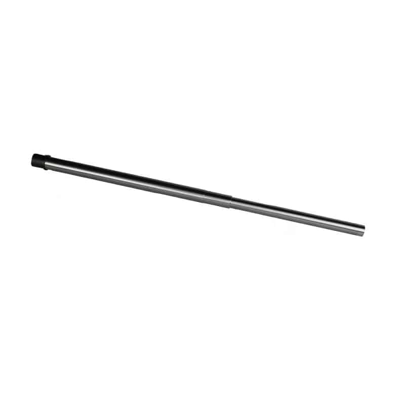

I would like to build an upper with a 24” SS barrel that will perform as well with 77 gr SMK bullets. I shoot from the bench so weight will not be an issue. I am looking at Criterion’s AR-15 24” barrel with a 1-8 twist. Are there better choices out there for my application?

That barrel will work fine.

I would get a White Oak or Compass Lake in 223 Wylde. I like a 7.7 twist personally.

Barrel – Looks like Krieger does not have a 24” barrel in stock or even listed. I guess you have to go custom.
I see White Oak offers two 24” barrels with a significant price difference. Besides twist rate I can’t see any difference between them.

One is from "White Oak Precision" - They're much nicer. I might be talking out of turn but I believe they are hand cut - hence the cost difference. I could be wrong, but I want to say that's correct.
I'll add that the "Precision" version will be worth every penny.
Interesting. I'm not finding the White Oak Precision 24" barrel from WOA's site.
There is a White Oak Precision service rifle barrel - it's built using a Krieger barrel.
I shoot a lot of WOA barrels and don't have anything bad to say about them. But my Kriegers will always outshoot them. If you are looking for the best accuracy, custom order what you want. If not quite the best is good enough for you, WOA, Criterion, and others will be a good choice.

I just received a response from White Oak about the differences between the barrels I posted:
The difference is the barrel blank we start with. White Oak Precision barrels ($495) are on a Krieger cut-rifled blank. The $300 barrel is on our match grade stainless steel button rifled barrel.
I have many barrels from them. Their standard ones (SPR / Varmint / etc) are very fine barrels... but don't hold a candle to the Precision barrels if you're shooting for score.
