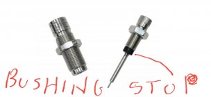

this is decap assembly screwed into the upper part at maximum possible depth and to push on bushing inside and still the pin is protruding from the bottom of the die

thanks for the additional image. I would expect the black jam nut would loosen and allow removal (unscrewing) the decap pin I do not have a die just like that so probably cannot help further
The bushing stop needs to be installed to use a bushing to size the necks.
I would try removing the decap rod. Drop in bushing, stop, & top screw in cap. Bushing should float a little to self center. Should size the necks?

edit: I think it isn’t actual “bushing stop“ as for example my expanding mandrel die has this nut too, I assume it’s there more like to keep the rod (decapping/expanding/…) aligned or supported not to bend. But thanks anyway guys I will probably to try to do it as 243win said :)

I think Redding may call it a bushing stop? Redding wants the bushing installed with the size stamp facing the cartridge.

You have two options. You can remove the rod and simply drop the bushing in, followed by the bushing stop, and the screw the top down. Or you can take the extra decapping rod that came with the die and cut the tip off.
I’ve personally done #1 with no issues
