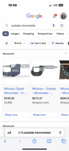

Ahh gotcha. I have a micrometer, two actually, one for necks (vernier/ball) and one of outside measurements (tube). So that's a good step one.
However, I'm not sure how I can use a tube mic to get the diameter reading right on the 0.200 line. Perhaps you can point me to a pic of how it's done?

I guess my remaining question is how to get right on the 0.200 line to measure with the tube mic. Is a measurement and a sharpie mark all we are talking about. And some +/- 0.010 variation not a big issue?
