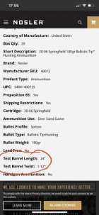

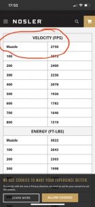

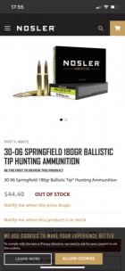

Nosler sells ammo for the 30-06 with that exact bullet so I see no reason why it wouldn’t stabilize perfectly fine at lower velocities. See photos below. Test barrel for the ammo was a 12 twist.
