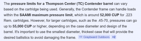

Did they take a .307 case and reform it with the Savage die? Making a rimmed .300 Savage? In either case I'd think both those cartridges operate above what a Contender is rated for, but IDK for sure.
I always wondered about some of the early TC frame and barrel
limits when i was running the Super 14's.......I did just locate this.
