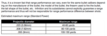

Copied and pasted from the online PDF of the user manual, since the OP couldn't be bothered:
Due to microwaves signals nature, range performance of the LabRadar can differ depending on the environmental conditions:
  • Temperature;
  • Humidity;
  • Particles in the air;
  • Signal reflection on the ground, trees, wall and any other surface in the line of fire.
  • Frequency channel used for transmission;
  • Electrical Interference in the area;
  • Etc.
In addition, the projectile’s characteristics will also affect the range performance of the LabRadar, such as:
  • Projectile’s diameter;
  • Projectile’s tail design;
  • Projectile’s shape;
  • Projectile’s position while travelling in the air;
  • Subparticles (ie. Sabot, wads);
  • Etc
Pretty sure you're reading *way* too much into that. It's generic a$$ covering; just go use the dang thing.
Just like any other instrument or measuring device, there is a certain amount of inherent uncertainty to the readings - if it reads '3000 fps' for a given shot, it could be 2999 or 3001. Maybe more; maybe less. Now you know why.

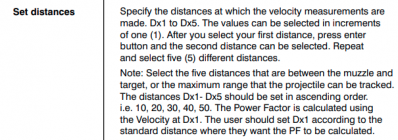

Here's my own personal take on this:
The LR has the ability to track bullets down range. The user can set up to 5 downrange distances (between the muzzle and the target OR the maximum range that the bullet can be tracked). I personally have never used this feature. I only use the LR for initial MV. Here are the instructions on how to set downrange distances Dx1 - Dx5:
Then one reads in the manual about how environmental factors that can affect range performance.
I read the manual - and I guess I read it differently. The section that was pointed out earlier with the environmental factors listed:
The environmental factors are listed in the section titled "Range". And notice the environmental factors is in reference to "range performance". And the section under the environmental factors concludes with a table which outlines the estimated "maximum range" of sample projectiles:
I think this is more about how environmental factors may affect the 'maximum range' the LR is able to track the projectile between the muzzle and the target - and accurately record downrange velocities at distances Dx1 thru Dx5 set by the user.
