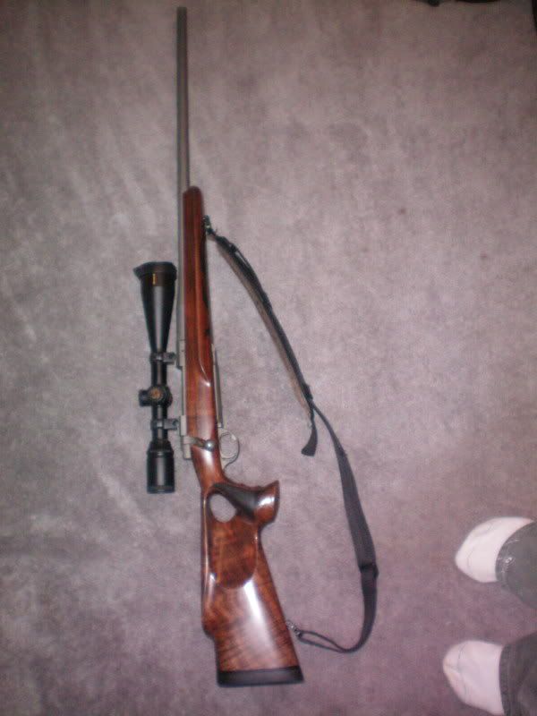

I have a custom 358 norma built on the tang m77 with a lilja barrel. My personal smith is always willing to work with rugers but my norma was built by a fella who specializes in working with the m77. His name is Dennis Olson and he lives in Plains, Montana. Business is called Olson Gunsmithing. He does the best work I've seen when it comes to modifying the m77s. If you do a Google search for him you'll find his number very easily.

Below are pictures of my Ruger M77 Tang Safety .358 Norma and the groups it shoots using 225gr Nosler Partitions and Hodgdon BLC-2 powder. It ALWAYS shoots this accurate. I even get under 1.5" Five shot groups at 300 yards with it. Of course it has a Lilja barrel which helps, but everything else on the action, other than a stiffer spring for faster lock time, is straight from the factory. The trigger is even factory and breaks cleanly at about 1 1/2 lb. with no creep or over-travel at all. Wonderful trigger.
