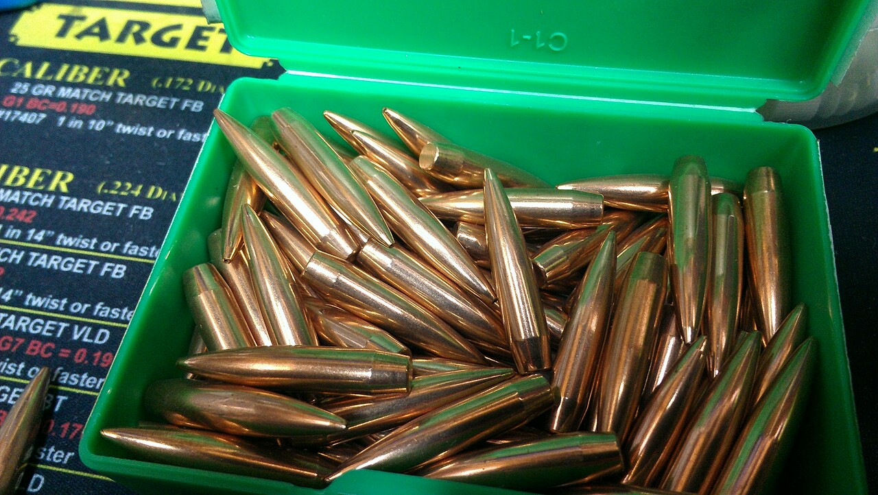

Seems to be a lot of confusion about Sierra's new offerings...
From what I've read here, the new 107s (as pictured) are indeed pointed (run through a pointing die).
They are ALSO offering a new set of bullets with plastic tips.
