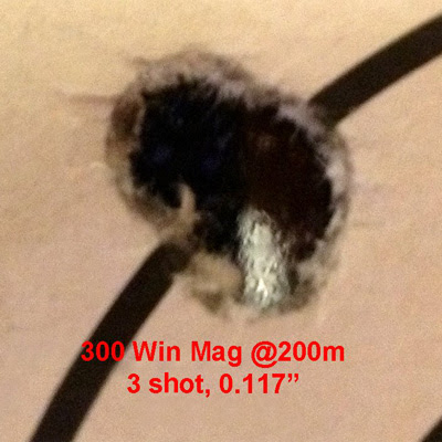

my best 3 shot group with the Sendero is .117 at 200m.
average is about .4-.5" at 200m
