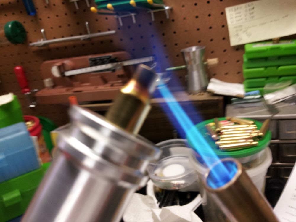

Not to beat this topic to a pulp, but I've found using an electric screwdriver is actually better as the turning speed is slower than a drill and easier to control to get an even "burn" all the way around. Works for me.
Alex

I get my cordless drill height all set up so I can rest the bottom of the drill on a thick wood block (I use a piece of 4x6) and the casing will contact the flame. So in one easy motion, I load the casing, swing it into the heat source, then a quick motion dump the brass into a steel bucket to cool. No arm fatigue doing it this way as i'm not actually supporting the drill, i'm just gripping the handle and working the speed. MAPP gas is simply propane with some added Acetelyne for a hotter flame..

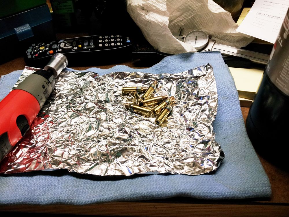

I lay out a small hand towel on the bench - then two layers of crumpled aluminum foil (to keet the towel from being burned)... then I drop the hot cases on the aluminum foil and let them cool. I do about 225 cases an hour, and often will do annealing for two or three hours, so the whole thing has to be easy, without fuss.

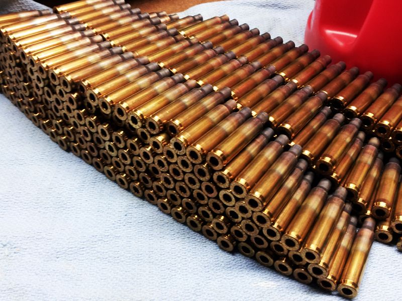

Not a problem. I determined the timing using 475f Temilaq just below the shoulder/body junction, now I just count seconds using a metronome, and rotate the case using a Lee locking stud and an electric screwdriver. The difference between, say, 6 seconds and 12, with flame applied only to the neck, is never going to overheat the lower part of the case. And, if anything, the extra time makes the cutoff decision less critical.
