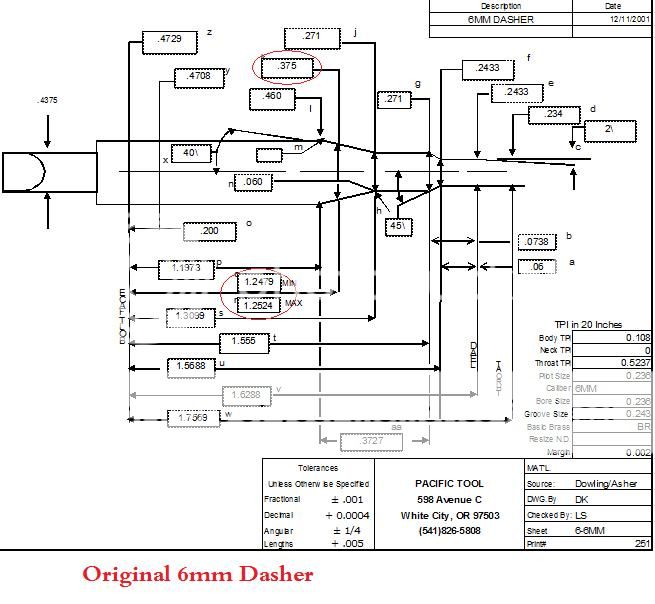

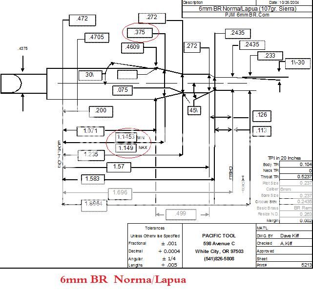

You can review the two prints that I’ve attached for a comparison. The way to accurately measure how much your chambering has been blown forward is to use a .375” Comparator. Subtract the 6mm BR length from yours.
Sounds like it is blown forward .0945" from the Maximum 6mmBR length. Very close to the Dasher! measure your fired case at the Shoulder/Body junction to see how close it is to the Dasher.
