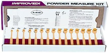

LEE PRECISION 90100 Powder Measure Kit, Yellow
You would be much further along with one of these kits.......They really do work well for feeding a beam scale.
Regards
Rick
