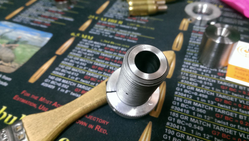

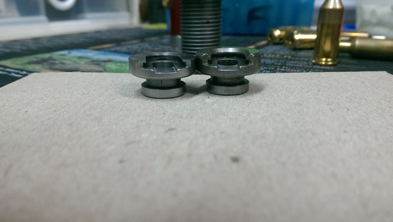

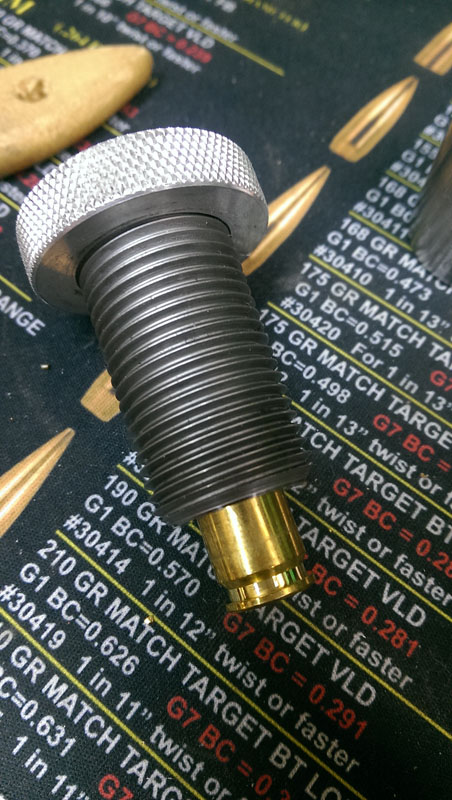

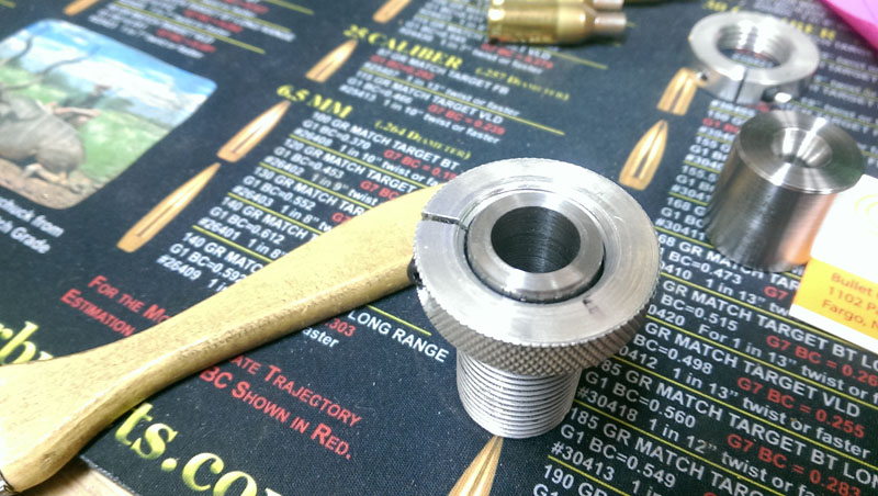

I made one for my Dasher cases from an old Forster die I had laying around. It is able to pull down the base only down .001" more than what my Harrells die does. Seems to help. I also modified a shell holder that allows sizing all the way past the extraction groove. I run the case in this die as a second operation after FL sizing.
On this die, most of the body and shoulder has been bored out. I may make a plunger that fits into my shell holder slot to push the case all the way through. I'm sure I can get another .0005" sizing due to the little bit of taper left in the die. I may experiment and see what happens.
Not much to see, but here is mine...
