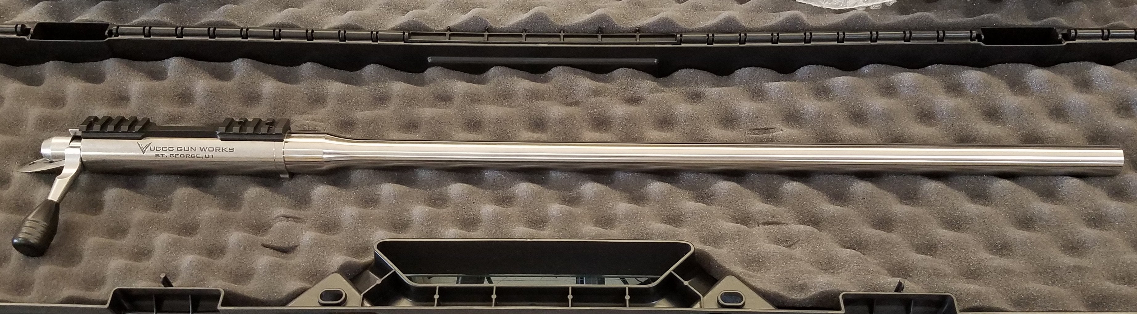

Why take a train when you can take a plane.? Vudoo single shot with a Benchmark, Shilen or Bartlein barrel or a used custom. Various used customs for sale here off and on at good prices
I went the single shot Vudoo route myself and do not regret it at all
