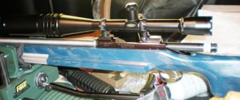

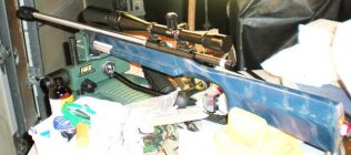

Hello All,
I'm a bit confused on the issue of rests.
I thought that one-piece rests were illegal in rimfire, and I see that people (incl. Joe Friedrich) have them in ARA matches.
I have a Gene Davis Rem 40X custom (see pic) and my first targets are shown (according to ontarget, the group size is 0.183", 0.349MOA). I use a Caldwell Fire control rest, a damn good rest for the $$$$. What competitions are one-piece rests legal in.
By the way of going to a match before you buy is a great idea. I'd like to see what others are using and possibly try out other things.
Steve
