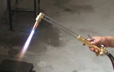

Following that line of thinking... perhaps someone could try this for an alternative annealing torch.
You'd just need to chuck your case up in a dremmel tool to make sure you had enough RPM for an even anneal. :)
