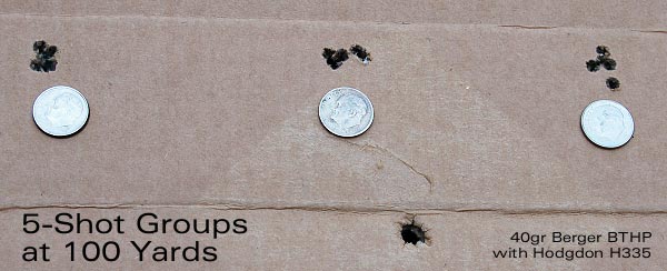

My two favorites are my 6.8 mid range rifle and a clone upper I built in 20 Practical. I like the bolt face diameter of 6.8 because it's a little stronger than the 6.5grendle, and the 20p is such an easy round to load and shoot with cheap components. My 100 and 200yard is less than 1/4 inch different with a moderate load under 39gr Speer in the 20.
I also shoot service rifle, so I have the requisite 5.56 NMA2 rifle that shoots fantastic, but that 20 is just a laser with 32gr bullets at 4000fps. Incredibly accurate and nearly zero recoil.

Alex, an AR in .20 Practical would be an outstanding choice, IMO. Forming brass is a snap - all you need is a couple of extra bushings for a .223 S type FL sizing die and you're in business. Very easy to load for, accurate, very little recoil and it runs beautifully on the basic AR platform. Powders that work for the .223/5.56 will work for the .20 P.
Great fun punching paper with this combination. A decent 1:11 twist barrel will produce remarkably small groups and if you ever decide to do some predator hunting, a .20 P is hard to beat for that purpose. Varmints, too. Easy to spot your shots in the scope because the crosshairs don't move off the target very much, even at high magnification.
I have a 20" DMR profile upper and a 24" heavyweight upper in .20 P and I shoot them more often that the .223/5.56 uppers. I'd be happy to share information.

If you have any thoughts of using this as a P-dog or ground squirrel slayer (the best sporting application of an AR IMHO), then I would concur with the .20 Practical option. Easy peasy, and this cartridge just wants to shoot. Robert Whitley has built quite a few. He told us: "I don't know exactly why, but pretty much every 20 Practical we've built has been really accurate".
http://www.6mmbr.com/gunweek090.html
