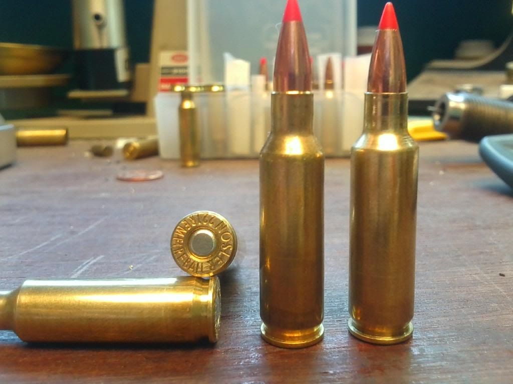

Here are a couple pictures for reference. While the two cases don't look that different in the picture there is a night and day difference between the performance level.
The left cartridge is a standard Vartarg, the right case is the new 20 SCC cartridge

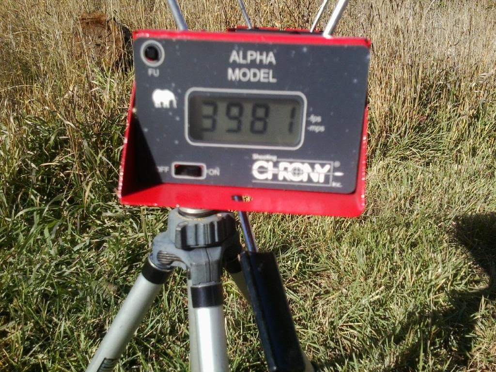

velocity while fireforming

I agree there is rarely a free lunch when discussing speed, barrel life, case life, etc. I believe the 20 SCC is the perfect mix between the 20vt and the 204 ruger. In my rifle i use 21.5 - 21.7 grains of Accurate 2200 powder to generate 4,000 - 4,100 fps during the summer in the pdog fields. To date i have done this with no noticeable barrel wear or brass failures. I believe the barrel life of the 20 SCC will fall somewhere between the 20vt and the 204 ruger. However that depends somewhat on the quality of the barrel used and even more on how the owner cleans/maintains/treats the rifle.
