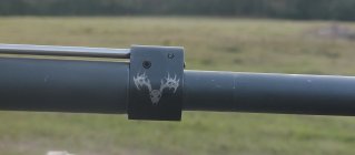

What the big deal with Adjustable Gas blocks?
Wolfdog91
Ok hope I don't sound like I'm being sarcastic or something but honestly can someone explain this to me ?
So I've never really messed with adjustable gas blocks but I'm. Constantly being told I should start using them . I don't shoot suppressed so just never saw the point. Well I got one for that 22-250 AR10 build I did because alot of folks said the issues with .22-250 in a gas gun where probably from poor gassing . Well I got one off of Grendel Hunter but never ended up using it because that thing worked perfectly with the standard one. So since it was just sitting on the shelf I tossed it on my .22 ARC build ....and after using both a non adjustable and this one.....egh I can't say I see what the fuss is about. I mean I got it tuned to give a good 3' O'clock ejection... But other then that I really don't feel anything different if anything I feel more recoil then with a standard non adjustable... Is it because I'm a non suppressed shooter or is there just something I'm over looking ? Thanks
View attachment 1708783View attachment 1708786View attachment 1708784
