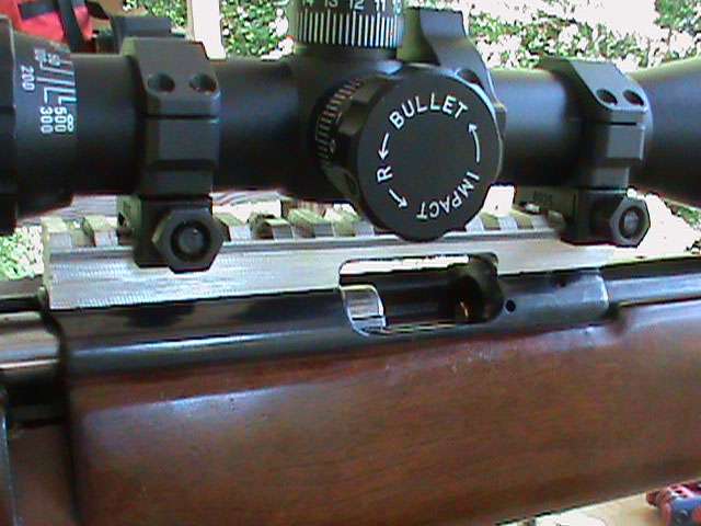

SWFA 16X mil-quad fixed power with a 50moa mount on an Anschutz Exemplar. This picture was right before switching the mil-quad off the Freedom and putting this one on the Freedom.

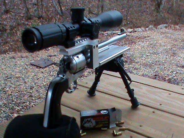

SWFA 16x older model with mismatched moa/mil turret/reticle but functions great. This has a 40moa mount with some additions to let me hang a bi-pod off it. Always wanted a long range rimfire revolver to just see what I could make it do. Just have to do some calculations on what you see for a hit/miss and how you calculate your adjustment. Not a big deal but some might struggle with it.

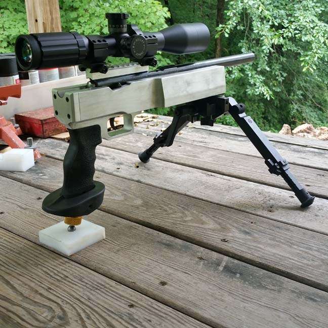

SWFA 16X older mismatched on a custom 50moa mount on a Vostok CM-2.

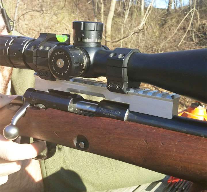

SWFA 5-20 HD on a Win 52-C with a 50moa mount. It now has a SWFA 16X mil-quad.

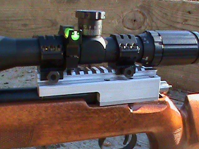

SWFA 16X on a Anschutz Super Match with 50moa mount. It now sports a mil-quad also.
