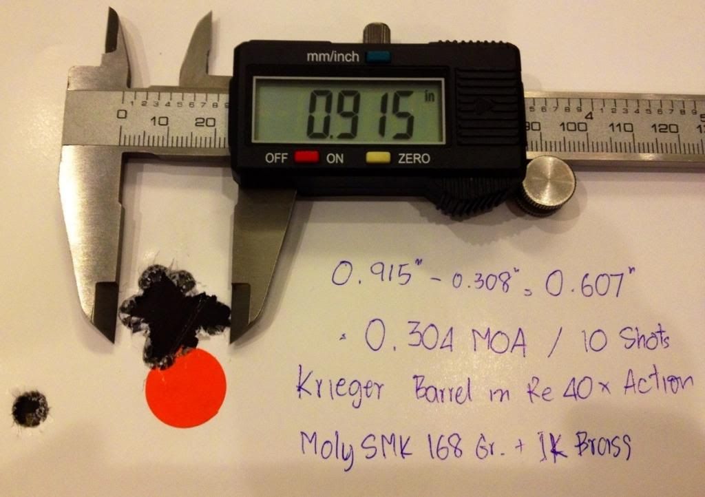

My friend had chamber a new barrel with my F-TR Reamer (.088 fb , Mag Box Spec)
Here is the 10 shots group at 200 yards.
Just worried about about another Single Shot Spec which may too long for my main projectiles
168 Hybrid
175 LRBT
185 Hybrid
