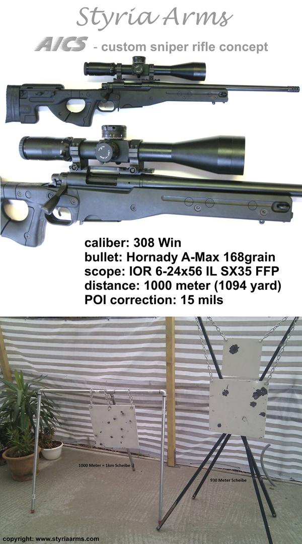

You need about 32 MOA / 9,5 mils for 1000 yard shooting.
With a 20 MOA rail it should work perfekt.
With a 40 MOA rail you can`t shoot centered at 100 yard - that`s a a big disadvantage.
I have learned: for long range shooting a higher elevation is more important than a high zoom factor.
Here a nice pic from a customers rifle. He use the IOR with 22 mil elevation + 20 MOA ( 5,8 mil) rail. And the IOR MP8 reticle has perfekt mil and half mil lines for longer distances too.
