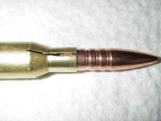

I use the split case method, as necchi has described. I was all set to buy the Hornady tool, but after a good discussion in another forum, I backed away from it. A number have bought the tool, and stopped using it, returning to the split case.
One advantage of the split case is that you can take a fired case from your own gun, and do a partial neck size only on it. The shoulder/body will be left untouched and with about 0.001 clearance. The Hornady tool uses a dummy cartridge that does not necessarily fit your chamber well, as it has to fit any chamber it is put into. Some users also report that it is finicky to use and no faster than a split case.
I've found there is a bit of a trick in using the split case, and also a "make sure" you do this. The trick is to seat the bullet just slightly long once you get close to where you think you have a to the lands position. If the bullet needs only to be pushed back slightly there is less chance it will hang in the lands and pull out when you lift the bolt.

Split Case Method
1. Take a neck sized only fired case, and use a Dremel to cut a single narrow slot in the neck and shoulder - just as shown in necchi's photo.
2. Select a bullet from the box you plan to load and fit it in the split case. Pick a bullet with a consistent flat tip, or file it a touch to square it up. Adjust case by squeezing the neck to increase tension as required. It does not need a lot of tension and just enough hold the bullet.
3. Carefully chamber it, and remove it slowly. If the ejector is pushing the case sideways, use your finger to keep the bullet from dragging on the side of the chamber or receiver.
4. Measure the overall length of the cartridge to the tip of the bullet, and record it.
5. Repeat step 4 until you get consistent numbers within .001". When you think you are close, then just pull the bullet a slight touch out from the self seated position and confirm it consistently returns to that same spot, and record the final length of the cartridge, and record in you loading book. Mark this bullet so you don't mix it up with the rest.
6. This length represents what overall length you need for that specific bullet to touch the lands. In my opinion just touching the lands is a poor position to seat too. I go either 0.010" longer to jam the bullet, or increments of 0.010" shorter to create a jump to the lands. Calculate your desired OAL to give the jam or jump you want, and record that number.
7. Use this marked bullet to load a live round long in the case, and by seating it deeper and deeper by trial and measure match the OAL you have calculated in step 6.
8. At this point methods may differ. Some save this load and use it to set up your die for the next loading session. I have a micrometer style seating die, so I just record the seating position in my loading book and use the test round at the range.
9. This test load, or recorded seating depth in theory is good for that specific batch of bullets, if it were not for throat burning. Especially when new the throat burns so is a moving target. So, especially with a new barrel you may want to repeat this exercise more often, or if you bought a large batch of the same bullets.
To be Honest, it doesn't work well with the Barnes TSX in the photo
