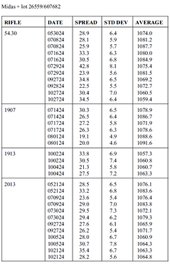

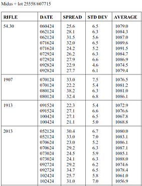

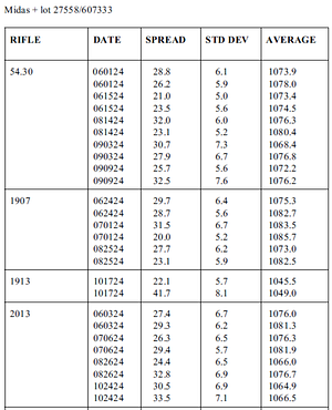

See the examples below that illustrate the range of SD/ES.
Went to verify zero at 50 yards. Shot a few different brands ammo and the best turned in a tight 20-shot group. The ES was 24 and SD 7. The ammo was Eley Tenex I purchased on a huge closeout at $30/brick and I bought an entire case for $300 plus sales tax. Why such a deal? It is from 2012 and had been found stuffed in a container until late 2025. To add to that, I had already shot two 10-shot groups of the same ammo and the SD was within a decimal point for each group (8.3 and 8.2) with ES 25.
My seemingly highly coveted Lapua Long Range turned in a ES of 47 and SD of 14 during the same session and same number of rounds fired.
