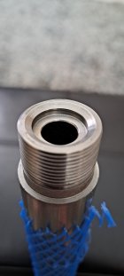

I assume you mean something like this?
I bought this Hart barrel from Jackie back in 2000 while I was stationed in Korea. It came from one of his Farley actions.
My GS did the mod you see and reamed it out to a 6-BR, .262 nk to match another rifle I have.
It was definitely worth the rechambering cost.
