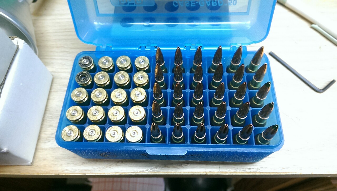

Yep, you sure did...lol.
I figured a visual with 220 Russian cases and FF cases would be worth "a 1000 words".

I care not if they rattle. I just hate it when I go groundhog shooting, hit 7 and put those cases in neck up, and miss 3, put cases in primer up (to keep score) and then when I get home find them all laying sideways in the box.... :o
I travel about half a day to go to competition shoots and over some very rough roads. Most of the calibres I use are setup with very little neck tension and I found that rattling around was affecting my seating depths so I try to reduce their movement in transit. One by travelling with them on a slight angle rather than standing verticle and then the inserts to restrict movement. I have had someone by accident knock over one of my boxes of sorted cases and all those that were not loaded ended up loose all over the inside of a box and thus all out of order. The insert keeps them in place, even up side down.
