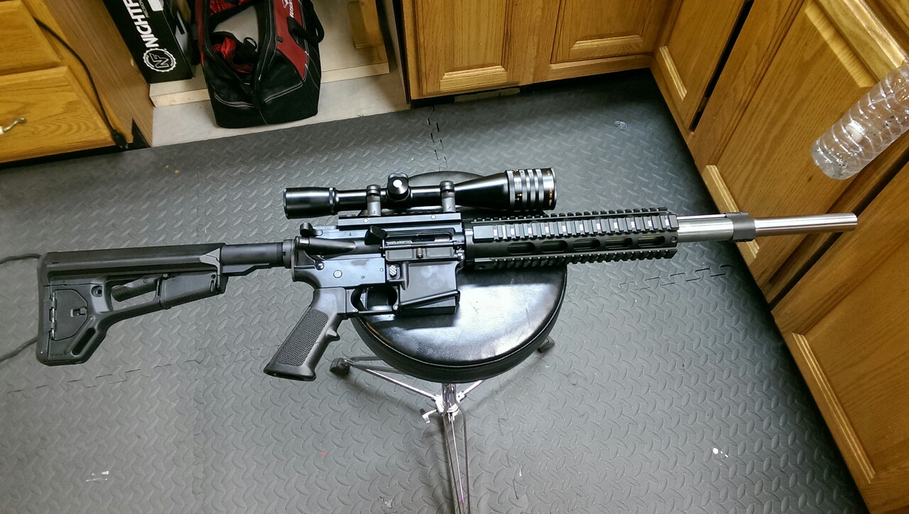

Got it all finished and its ready to test out!
The barrel machined very nice! Hopefully it shoots as good as it looks.
