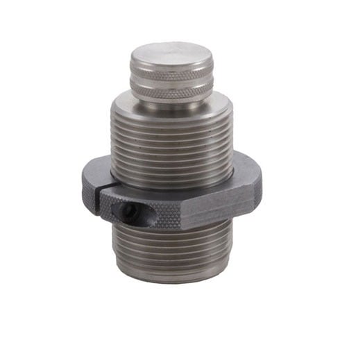

Are you using expander mandrels?
Might Try these
Or these
Cortina makes some cool stuff
I'm wondering if maybe you need to do an intermediate step say to 284 first before going straight to 30

Not sure what's causing your issue but it's generally a very straightforward operation. You might get an expander die and mandrel. I'm betting that will cure whatever problem your having.

Might need to expand the brass in steps instead of one big step from 6mm to 30 cal. A .270 expander will put you in the center of the one step. However, Redding makes a die button that will take the necks up from 6mm to 30 cal. but still requires good lube of inside of the necks. I find it best to use expanders instead of using the sizing die to bring the necks up to 30 cal. Once this is done then move forward with turning the necks to fit the chamber.

Use one of these with lube inside the neck and on the expander; start it in to open up the neck, pull it out, spin the brass 1/2 turn, ease it the rest of the way in. Works like a charm.
Forgot to add, be gentle.
Get the pma expander mentioned above.
This is how I do it as well and never had a split neck or collapsed shoulder. Works great.

You have to expand the 6BR to 30
In other words .243 to .308
I expand by using a 308 mandrel
Set the case in the shell holder
Lube the mandrel ( also inside neck a bit)
This is not one big push
Rather run the case into the mandrel a bit
Down with the case
Turn case roughly 90°
Back into the mandrel a bit further
Check the lube on the mandrel, make sure it’s lubed
Continue to run the case into the mandrel a bit more each time and lower it and spin the case again
Eventually the whole neck is opened to the correct diameter. Nothing gets crushed
You now have a case that be loaded like any other.
The lube etc., is a matter of preference.
All of the above is what I do. And for me it works perfectly every time.

You don't expand the necks in a regular sizing die. You use an expanding mandrel in a expander body. PMA, Sinclair and others make these. I expand from 6 to .30 in one step using a tapered Redding expander. If you're not equipped to do this, I'd highly suggest you buy some some brass that's prepped and neck turned for your first time. -Al
