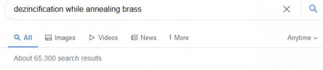

Look up “dezincification while annealing brass”. The rose gold color is a classic indication of over annealing leading to brass dezincification. There are a few other reasons but dezincification would be near the top of my list without knowing more information.
