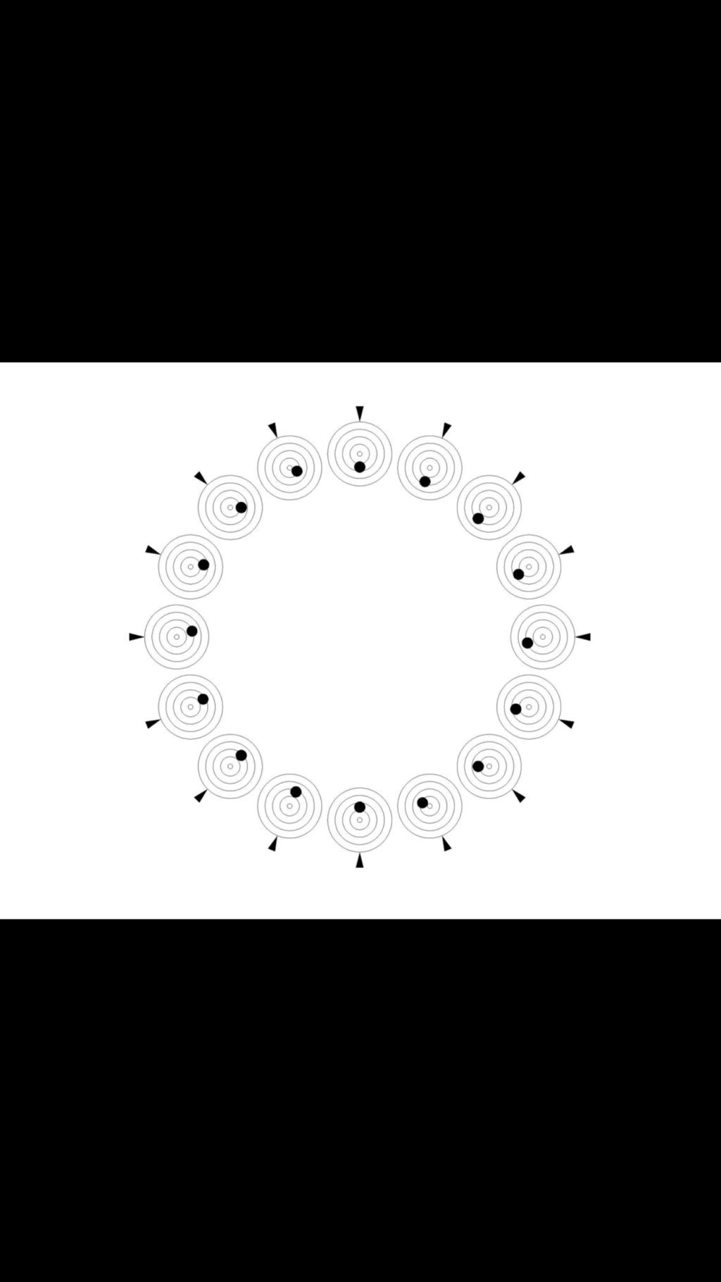

Here’s a chart of what I typically see with conditions. The problem with these charts is they don’t show Bullet impacts at different speeds for the same condition.
Lets say you catch a steady condition blowing at say 2 o’clock wind right to left blowing at 10mph. Bullets are printing nicely at 12 o’clock on the mothball and the first three shots go into one hole. Suddenly you shoot but the wind has picked up to 15mph. That shot will go out of the group down and towards the left at the 8 o’clock position! By the time you load the gun and fire the wind has changed to 5 mph. That bullet will go up and out of the group at 2 o’clock. So the same condition with different intensity can make your Bullet hit low or high realative to your group.
I watched this happen to my buddy several times this week at St. Louis. He’d have 4 in a knot and his last shot was low and left due to a pick up.
