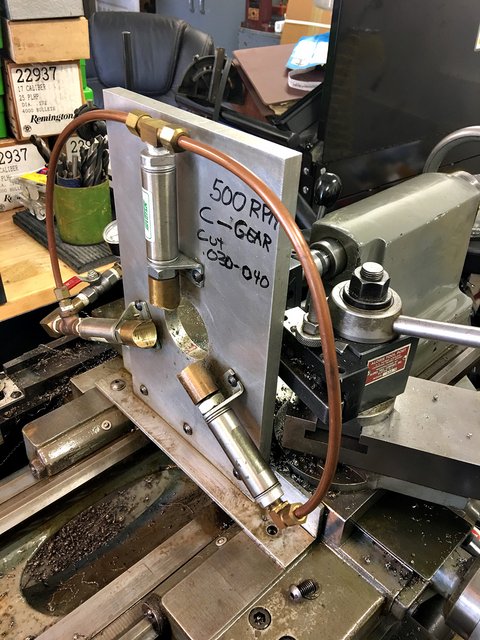

I was thinking of making a simple, belcrank style weighted follow rest. Instead of using springs or pnuematics, just a simple pivoted bellcrank with lead weights to back up the tool. That way it will work on contouring tapers. Not exactly like this, but sort of.. Has anyone ever seen anyone use something like this? I hear that it is not that uncommon.

The problem with the design you have is that it doesn't fight the "climb" of the barrel....which is dynamic based on the diameter and distance between centers.
I suggest chucking up a tube and spinning it up, try to counteract the chatter and see how you can skin the cat.
Short of a grinder, a pneumatic rest is about the only frustration free way to even consider this.
It can be done without, but you WILL spend a lot of time on it.
