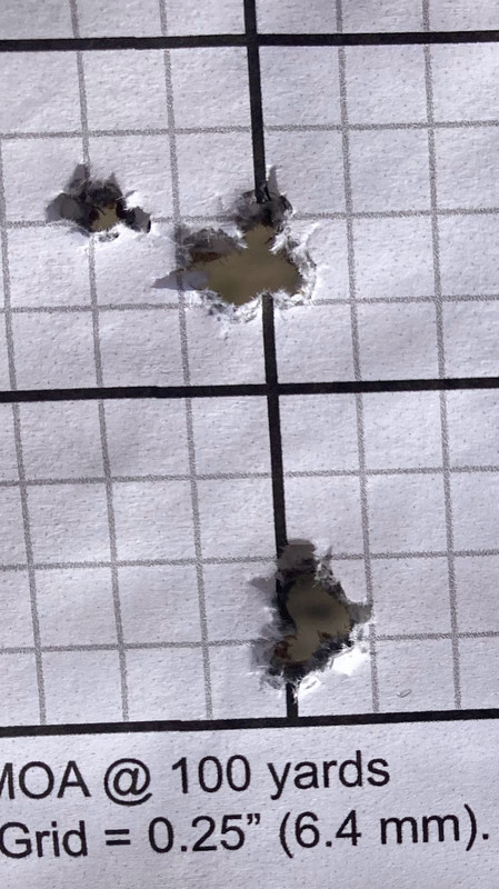

I just shot both these targets about 30 minutes ago - 50 yds, CCI S/V, Tikka T1x,
I shot the bottom target first - just a light flitting of the tails of the flags (surveyors tape)
I shot the top target next and if you notice it is now slightly more left because I had picked up a very slight left running breeze On the 3rd shot the flag jumped out about 45 degrees which equates to about a 5-6 mph breeze and it pushed the shot out almost a half-inch. If I hadn't had the flags I would not have known what caused it to go out that far and would have called it a flyer.
That's about what my 50 yard groups look like LOL I know the conditions are my biggest challenge, especially where I shoot on the Mtn. There's wind there even when there's no wind. Switches back and forth and pretty tricky to nail down.
