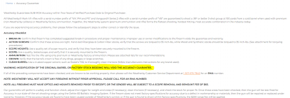

I was going to do that, but if I bed the rifle in any way, I void the warranty. :(
