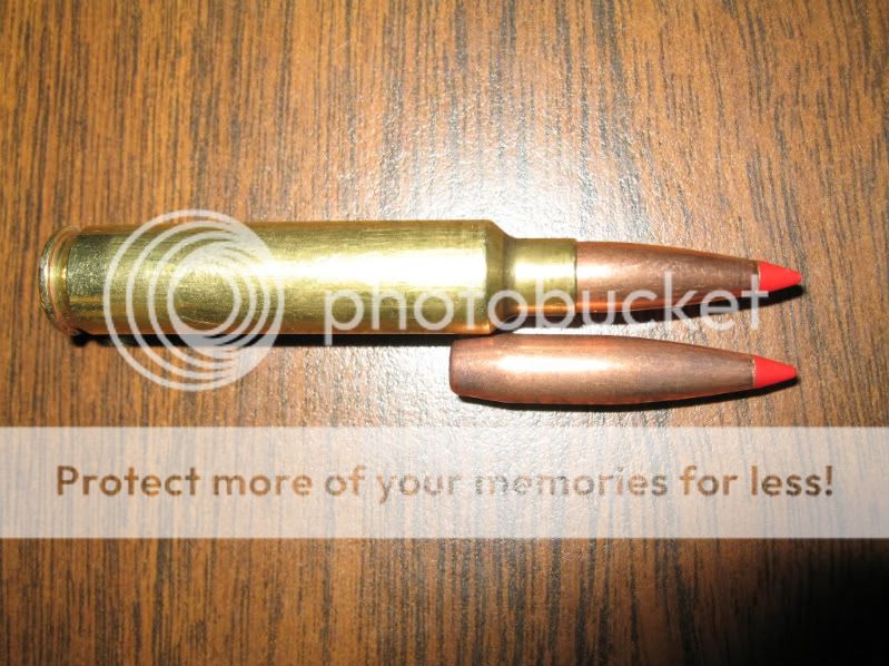

...DPMS created when they dropped the AR-15 VLD magazine (in all fairness i think the guy that was making them for DPMS died, as far as i know). Here's a couple pics on how it functioned--
That's the 75 A-Max loaded to VLD magazine length. This system helped tremendously with long-range varminting.

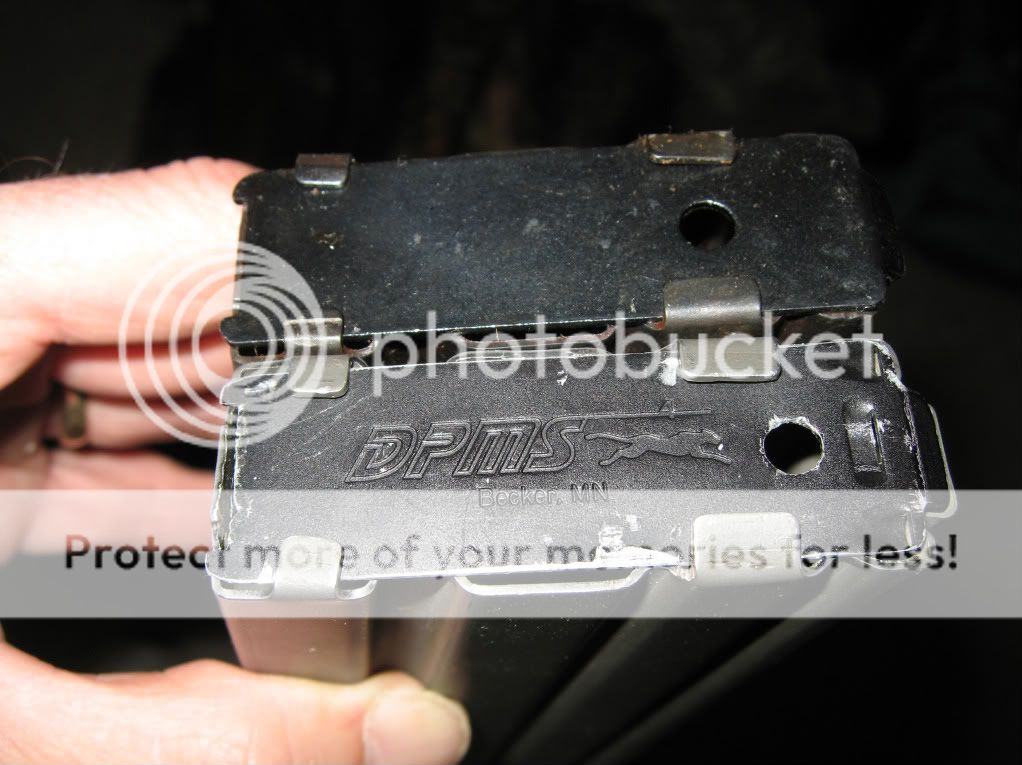

I heard the LRP's guy died, and i think he was making them for DPMS. Here's both...i think--
the lower receivers had to be modified to accept them for them to work. i know that the bolt stop was one of the mods. my friend shoots a Scott Medeesha match rifle modified to shood the LRP mags. most of the problems had to do with feeding--i can ask my friend what kind of problems he had with them. he uses them in matches--so i guess he has the problems ironed out. DPMS said when i talked to them last that they were thinking about doing a run of the LRP magazines--but that never happened.
I remember my gunsmith saying he had to adjust the feed lips on the magazine also. I think he said it interfered with the bolt body as it went by. Yes u do need the VLD bolt stop as well, but that's nothing to change back and forth.
