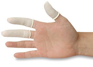

Finger Cots, they run about $5.50 per gross
